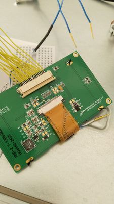

I want to interface NHD-2.7-12864WDW3 OLED display with STM32H755 Nucleo and show some data in display
-4 wire SPI-. I had connected all OLED pins to STM32 correctly and than tried to flash this code (that I've attached). But i did not get any output, OLED display did not even glow.
I dont know where i am doing wrong, can you help me on this regard?

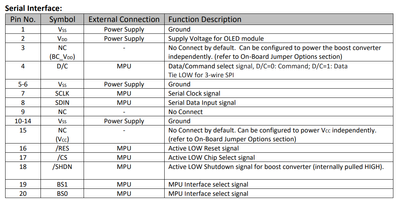

Pin 1 (VSS) → GND
Pin 2 (VDD) → +3.3 V
Pin 3 (NC / BC_VDD) → no connection
Pin 4 (D/C) → PA9 (GPIO Output)
Pin 5 (VSS) → GND
Pin 6 (VSS) → GND
Pin 7 (SCLK) → PB13 (SPI2_SCK, AF5)
Pin 8 (SDIN) → PB15 (SPI2_MOSI, AF5)
Pin 9 (NC) → no connection
Pin 10 (VSS) → GND
Pin 11 (VSS) → GND
Pin 12 (VSS) → GND
Pin 13 (VSS) → GND
Pin 14 (VSS) → GND
Pin 15 (NC / VCC sense) → no connection
Pin 16 (/RES) → PA10 (GPIO Output, active LOW reset)
Pin 17 (/CS) → PB2 (GPIO Output, active LOW chip‑select)
Pin 18 (/SHDN) → +3.3 V

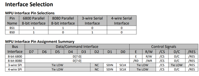

Pin 19 (BS1) → GND (BS[1:0]=00 → 4‑wire SPI)
Pin 20 (BS1) → GND (BS[1:0]=00 → 4‑wire SPI)
Note: The pins seen as short circuit in the photo are GND pins.

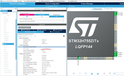

2025-07-30 4:05 AM
I've changed data size from 4 bit to 8 bit but the result is same :(
2025-07-30 4:05 AM

2025-07-30 12:24 PM - edited 2025-07-30 12:25 PM
I think you need to work with New Haven, and perhaps get a scope or analyzer on the signals.
I'd probably double check that the SPI Transmit completes before pulling the Chip Select High again. Need to make sure the last bit crosses the wire, I think SPI TransmitReceive function achieves that, whereas TXE is more relative to the first bit over the wire. Is there a BUSY or TC bit you can spin on?
Ok, what does that actually mean? SPI should be sending 8-bit bytes a bit at a time. You're not using the parallel modes.
