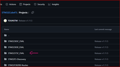

2025-09-25 5:07 AM - edited 2025-09-25 5:38 AM
Thank you, FBL
For this Suggestion. I will Look into it.
By the way , you Suggested to use DFU of STM32373C_EVAL , Would it better to use DFU of STM32303C_EVAL "OR" STM32F3-Discovery ? Considering my Device : STM32F303rb.
Also , if you can Confirm these DFU example resembles to this Training Session : https://www.youtube.com/watch?v=n_LDXOQHerU
Thanks.
