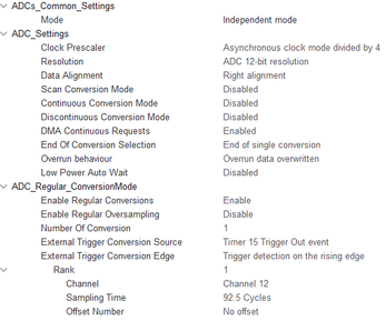

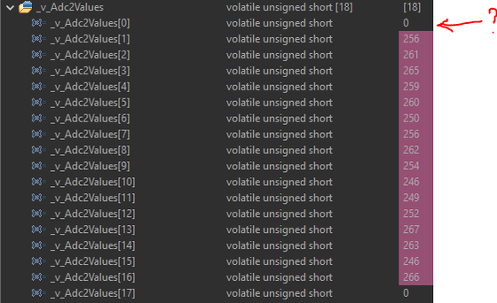

Using ADC2, one channel IN12, triggered by timer every 100µs, using circular DMA sized of 16 half-words, the array [0] value is always 0, the array's index used by DMA is from 1 to 16, not 0 to 15. See below screen shots :
code :
volatile uint16_t _v_Adc2Values [18]; // Define to 18 to see the shift
HAL_ADC_Start_DMA (&hadc2, (uint32_t *) _v_Adc2Values, 16);
HAL_TIM_Base_Start_IT (&htim15);
result :
When I starts my software this morning to make the screen shots, the 1st start, I have not the issue, the values comes from 0 to 15 in array. Then I restarted my software several times, and all these tries the array result was shifted like the screen shot.

I think the DMA settings are missing in your description.

> ... the array is shifted.
Not exactly. The values have shifted within the array.
Which indicates the DMA target address has changed.
2025-10-01 12:44 AM
I would like to say that values are written by DMA in array from index 1 to 16 instead of 0 to 15.

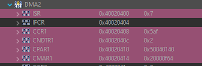

DMA register CMAR is correct, it's the _v_Adc2Values [0] address.
