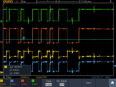

  • Scope on CANH/CANL (diff trace CH1–CH2) shows a dominant ACK bit in the ACK slot (!)

  • Scope on CANH/CANL shows clean dominant bits. The CH1–CH2 differential (pink) clearly shows a dominant pulse in the ACK slot.

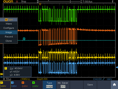

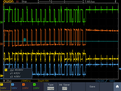

suyog1
Associate II
Channel 1 - CAN H
Channel 2 - CAN L
Channel 3 - D
Channel 4 - R
