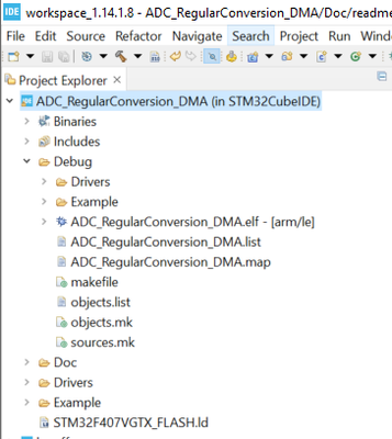

Thank you @STTwo-32,
I have successfully managed to generate the Makefile by using the build action in STM32CubeIDE; however, I am not able to Run the project onto my STM32F407G-DISC1. Either from the IDE or VSCode.
One thing that confuses me is that I do not find any configFiles such as stlink.cfg and stm32f4x.cfg
2024-04-30 6:55 AM
These files are for OpenOCD. The default debugger in CubeIDE is the "ST GDB server", it does not need these files. If you switch to OpenOCD, the config file will be created.
