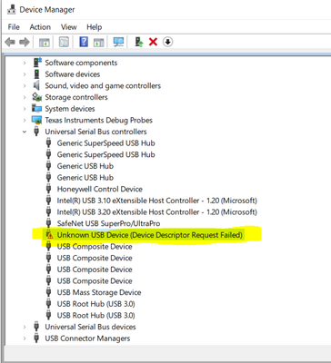

2024-04-30 2:27 AM
Hello Hardrock,
Thanks for the lead. Although I generated a code using AL94.I-CUBE-USBD-COMPOSITE.1.0.3.pack software package I am still facing some issue in device discovery. Attaching snapshot for the reference.
Kindly anyone help me to resolve this and please let me know will this AL94.I-CUBE-USBD-COMPOSITE.1.0.3.pack software package is compactible for H5 as well.
2024-04-30 3:03 AM
1. You must install "STM32 Virtual COM Port Driver" for USB CDC in your PC.
https://www.st.com/en/development-tools/stsw-stm32102.html
2. For the USB Composite CDC and HID, you have to design the custom interface respectively.
/Middlewares/Third_Party/AL94_USB_Composite/COMPOSITE/App/
[USB CDC] usbd_cdc_acm_if.c
[USB HID] usbd_hid_custom_if.c
for example, CDC_Receive() in usbd_cdc_acm_if.c
this sample interface just echo back on same channel.
* USB COM RX Interface : CDC_Receive()
* USB COM TX Interface : CDC_Transmit()
static int8_t CDC_Receive(uint8_t cdc_ch, uint8_t *Buf, uint32_t *Len)
/* USER CODE BEGIN 6 */
//HAL_UART_Transmit_DMA(CDC_CH_To_UART_Handle(cdc_ch), Buf, *Len);
CDC_Transmit(cdc_ch, Buf, *Len); // echo back on same channel
USBD_CDC_SetRxBuffer(cdc_ch, &hUsbDevice, &Buf[0]);
USBD_CDC_ReceivePacket(cdc_ch, &hUsbDevice);
return (USBD_OK);
/* USER CODE END 6 */
