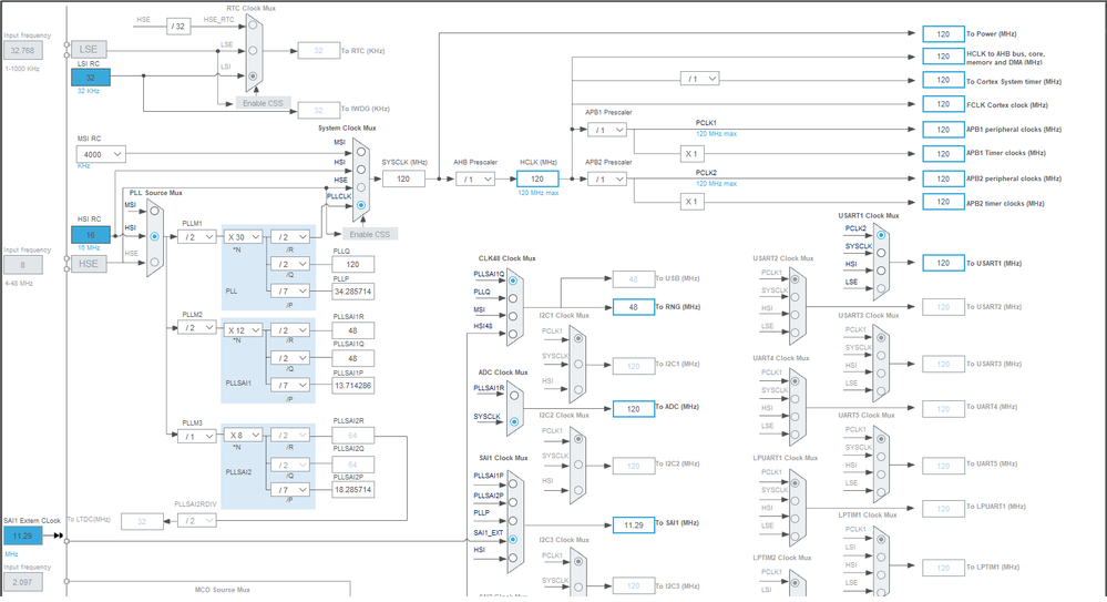

2020-11-26 1:11 PM
This is the clock config I have in CubeMX
