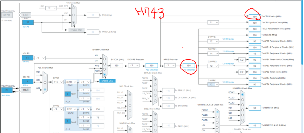

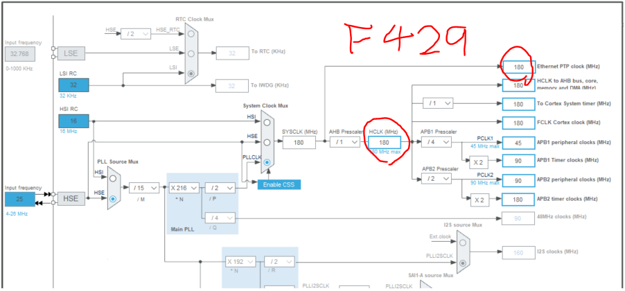

I'm trying out stm32h743 now, and try to make output signal from GPIO.
I've set same frequency on F429 & H743 with same code. However, The the signal much slower(longer) in H743.
(well... my purpose is to shorten the length of the signal as much as possible)
Even if I maximized frequency of H743, the signal of H743 is still much slower(3200ns) than F429.
Could anybody help me to figure out the reason?
Thanks in advance.
