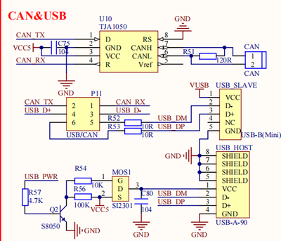

This is a third-party development board named "Explorer". I will provide the USB schematic section. The USB DEVICE I refer to is the USB DEVICE in CubeMX.I regret that I don't have professional measuring instruments and can only judge the success by using software such as a serial port assistant.
