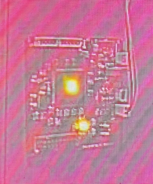

I already soldered the 3.3V regulator back so it is the other one heating here (lower right corner) due to the huge power the UC is draining. Like you can see the middle of the UC heats up and it heats up quickly. Sorry for the crappy image, my thermal camera just didn't want to communicate with pc so took a picture of the screen..
