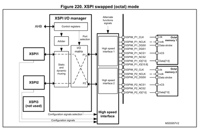

I looked it up and found that to boot via Nor-Flash (quad), I need to connect XSPI1 to XSPIM_P2. Also, since I try to connect the 16-bit PRAM in DTR without DQS mode, I connected it as XSPI2->XSPIM_P1. Is this correct? I really need to BOOT via Nor-Flash and use PRAM after that. (swapped mode? in CubeMX)

Hello @AndersonKKK ;
The swapped mode is similar to XSPI direct mode, but the ports are swapped, to help I/O mapping.
In swapped mode, the XSPI2 can be configured in 16-bit mode, and the XSPI1 can be configured in octal mode, to connect an external 16-bit memory on Port 1, and to connect in a concurrent way an octal external memory connected to Port 2 of the I/O manager.
To check a hardware connection, I recommend you to look at Getting started with hardware development for STM32N6 MCUs - Application note.
