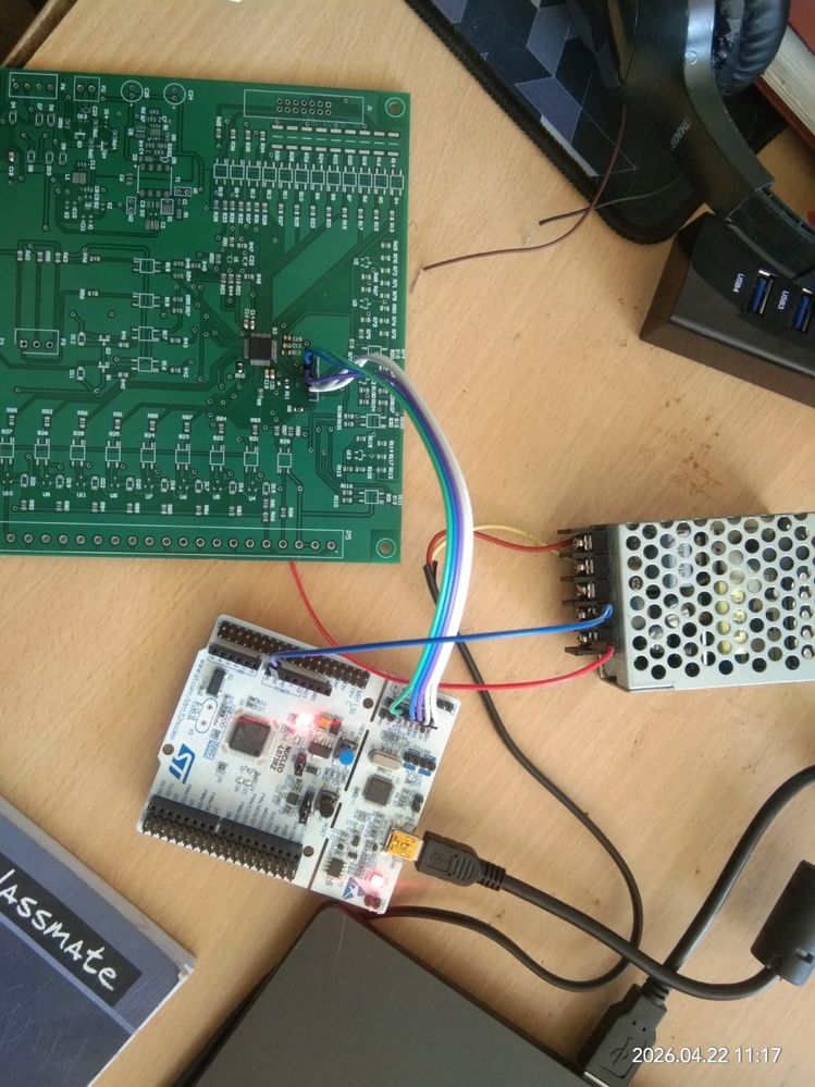

I am facing a persistent "Target no device found" error when trying to program an STM32L073CZT3 custom board using a Nucleo-L073RZ as an external ST-LINK (CN2 jumpers removed).
Hardware Setup:
  • MCU: STM32L073CZT3 (custom PCB)
  • Debugger: ST-LINK V2-1 (Nucleo-64)
  • Connection: 5-wire SWD (SWDIO, SWCLK, GND, NRST, VDD_Sensing)
  • Power: External SMPS providing 3.3V (Common Ground established between SMPS and ST-LINK).

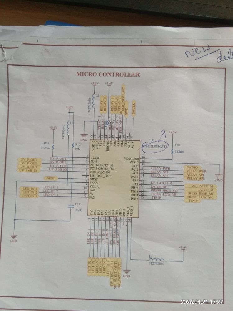

  3. Schematic Check: I have a 10uF capacitor (C17) on the NRST line—could this be preventing the debugger from catching the reset state?
  4. Verified that the ST-LINK and the software setup work perfectly on a standard Nucleo-L073RZ board.
I have attached my schematic and a photo of the physical wiring. Does the 0V on SWDIO suggest a software-locked pin or a hardware fault within the MCU?

Is there any mistake in our schematicWhatsApp Image 2026-04-21 at 17.27.43.jpeg
Title:
STM32L073 custom board – SWD works on other boards but not on my PCB (schematic check)
Hello STM32 Community,
I am facing an issue while trying to program my custom board using SWD, and I would like to confirm if my debug connection and schematic are correct.
Hardware Details:
  • Debugger: ST-LINK (from Nucleo board, CN2 removed)
  • Interface: SWD (external wiring)
Working Case:
  • I separated the ST-LINK from the Nucleo board
  • Using the same SWD wires, I can successfully program another STM32 development board
    ✔ So ST-LINK, wiring, and software are working fine
Problem (My Custom Board):
  • When I connect the same SWD lines to my PCB → “Target no device found”
Connections Used:
  • SWDIO → PA13
  • SWCLK → PA14
  • NRST → NRST
  • GND → GND
  • VREF (3.3V) → VDD
Checks Done:
  • VDD = 3.3V present on MCU
  • VDDA connected through inductor
  • NRST capacitor issue fixed (removed 10µF)
  • BOOT0 tied to GND
  • GND is common between ST-LINK and board
  • Same setup works on another board
Request:

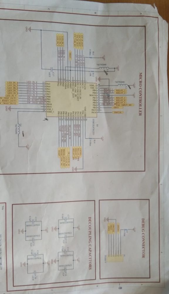

I have attached my schematic image. Could you please check:
  1. Is my SWD/debug connection correct?
  2. Any mistake in power design (VDD / VDDA)?
  • Schematic image (attached)
Thank you for your support!

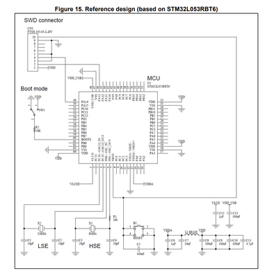

Please refer to the hardware getting started application note AN4467, especially the figure 15:
And check again this knowledge base article: How to program an STM32 using the on-board ST-LINK/V2-1 of the NUCLEO-WB55RG

Although it is possible to use the ST-Link from a Nucleo like this, it does add a few extra complications.
Therefore I would strongly recommend that you get a standalone ST-Link - they are not expensive, and it makes life a lot easier!
See here and here - among others..

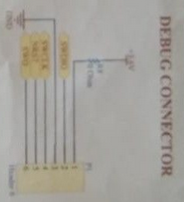

Mike_ST
Hard to tell with not so detailed pictures.
Check for bridged pins on the STM32.
Check for rotated chip.
On your implementation of the debug connector, I maybe see that you've switched SWCK and SWIO compared to our implementation on the nucleo, please make sure this is not the problem.
