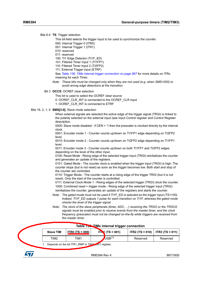

2021-04-18 2:32 AM
> TIM2->SMCR |= LL_TIM_TS_ITR1;
This probably is the cause of the problem.

Just change TIM2_SMCR.TS to ITR0.
