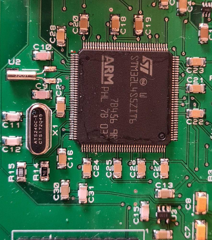

Thank you all for your answers. Just a sanity check that the orientation is correct? I'm 99% sure it is but anyhow. In the picture top left corner pin 1 and from there ccw numbering goes. Thank you in advance.
2021-04-03 3:46 AM
That is right. With the text visible normal, Pin 1 is left bottom
