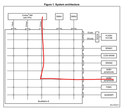

Writes are not instant. There is a bus which carries data through the system to where it needs to go, in this case it needs to go from the CPU to AHB2 where the GPIOs are. This takes more time. When the write actually occurs, the CPU is processing other instructions. Use DSB to enforce barriers between writes if it is important that X happens before Y.
Having the debugger active at the same time can also disrupts timing within the system.
Toggling pins with the CPU is not a good way to get precise timing. There are a variety of peripherals such as SPI or TIM that can do this with tick-level precision.
