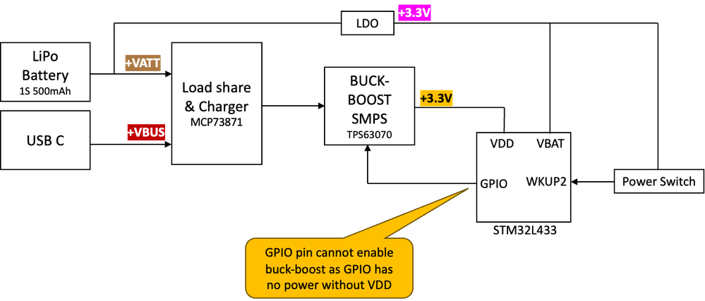

1. The WKUP2 pin currently uses the 3.3V from the buck-boost converter (I copied the same circuit used on the Nucleo develpment board). But if I disable the buck-boost converter then there will be no 3.3V supply to the switch for the WKUP pin, so the STM32 would never wake. The circuit is shown below..
2. The battery is 1S so could be up to 4.2V, but the VBAT pin can only handle voltatges of 1.55 to 3.6 V. So how do I power the VBAT pin using the 1S battery ?

2026-01-03 1:44 AM - edited 2026-01-03 1:45 AM
This is the issue I have, its a chicen and egg situtation
To enable the 3.3V buck-boost converter, the STM32 needs to set the GPIO pin high.
However, if the STM32 is only powered by the VBAT pin, then the GPIO pins are not powered so the buck-boost converter cannot be enabled.

2026-01-03 11:22 AM - edited 2026-01-03 11:59 AM
Thats useful information about the self discharge and an average current draw of ~14uA (how did you calcuate this current draw out of interest ?)
At the moment though, when in shutdown the current is ~500uA so I expect this can be significantly improved (especially as STM32 shutdown current is 70nA).
I think the majority of this current is due to the 3.3V buck-boost converter (TPS63070), so when I investigated the VBAT pin on the STM32 I realised there could be a way to disable the 3.3V buck-boost converter and reduce the current draw.
I have just implemented the following circuit so I can disable the 3.3V buck-boost converter...
When the button switch is pressed....
During shutdown/standby....
I had to use a regulator and diode that I had lying around, so there are probably more low power versions I can use, but I just wanted to check the method works.
The current in shutdown has dropped to 33uA (still high but better than 500uA).
But after first testing I have found it has had a knock on effect, such as...
