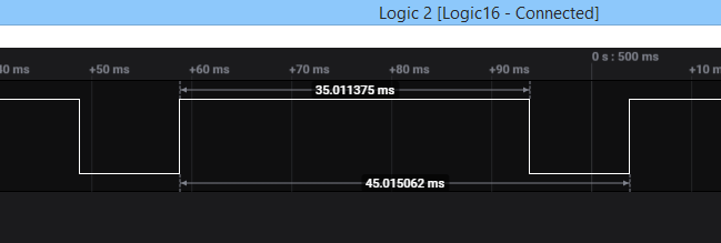

Hello community!
My mcu is STM32H743IIT6 tqsp176 from blue waveshare board. I create a new project from Cube with HAL. Then I make the simplest flashing cycle of the LED:
volatile unsigned long x = 0;
while (1)
while (x++ < 2000000) {}
x = 0;
HAL_GPIO_WritePin(GPIOI, GPIO_PIN_0, GPIO_PIN_RESET);
x = 0;
HAL_GPIO_WritePin(GPIOI, GPIO_PIN_0, GPIO_PIN_SET);
}Any changes in code result in accidental change in frequency and DUTY CYCLE. For example:
1) When I make variable x global or local.
2) When i put beforce blink cycle this line HAL_GPIO_WritePin(GPIOI, GPIO_PIN_0, GPIO_PIN_RESET);
3) When i add new variable such Y to cycle:
volatile unsigned long y = 0;
while (1)
y = x;
x = 0;
y = x;
x = 0;
}In this case frequesy change in random range. Can get X times higher, and can get X times lower. Duty cycle can become 10% / 90% or 30% / 70% and other.
4) When i put some code before this cycle frequency and duty cycle also change!!!
5) Even just when I move some code in places!!!
volatile unsigned long y = 0; // <<<<<<< declare first
while (1)
x = 0; // << move x here
y = x;
y = x;
Absolutely any changes in code result in accidental change in frequency and DUTY CYCLE.
I try mcu work on HSE, PLL, HSI... there is no difference. I try keil compiler v5 & v6.. no difference. I try to create project without CUBE and HAL ... there is no difference. I try any dividers and clocks ... there is no difference.
MCU broken?

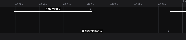

2020-03-04 1:18 AM
Forget software delay.
I used a timer and in it interrupt handler i toggle led pin. It did not help!
unsigned char flag = 0;
void TIM8_BRK_TIM12_IRQHandler (void)
if (TIM12->SR & 1UL)
TIM12->SR = 0;
if (flag)
H12_ON;
flag = 0;
else
H12_OFF;
flag = 1;
int main (void)
RCC->APB1LENR |= RCC_APB1LENR_TIM12EN;
TIM12->ARR = 10000;
TIM12->DIER |= TIM_DIER_UIE;
TIM12->PSC = 1000;
TIM12->CR1 |= TIM_CR1_URS;
TIM12->CR1 |= TIM_CR1_CEN;
// timer configured for 0.1s period with 400 MHz clock core
//LED_ON;
NVIC_EnableIRQ(TIM8_BRK_TIM12_IRQn);
__enable_irq();
while (1)
}Then i uncomment // LED_ON; before main cycle!!
It is norm?
