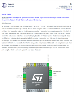

I have written the code below that I'm using to print the Hello World which I have found online. Also I do not know if their is any problem on the code. With this I have also attached the Pin Configuration and Clock configuration details below as images.

I don't think so. He's doing the printf retarget but in a wrong way:
int _write(int file, char *ptr, int len)
int i=0;
for(i=0;i<len;i++)
ITM_SendChar((*ptr++));
return len;
And he already shared the pinout config using USART2:
