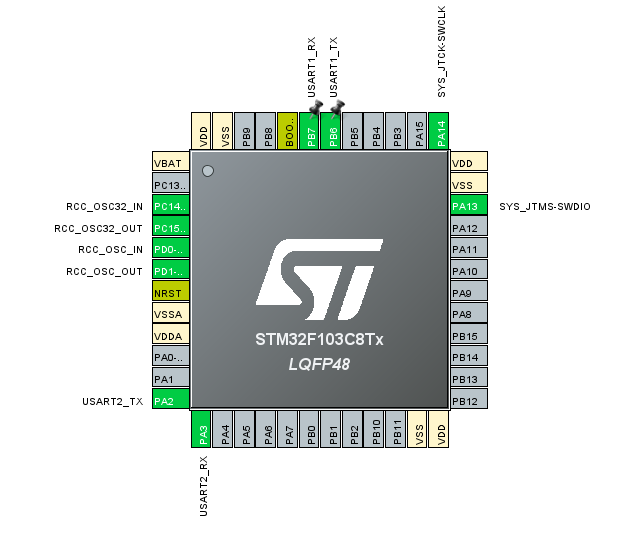

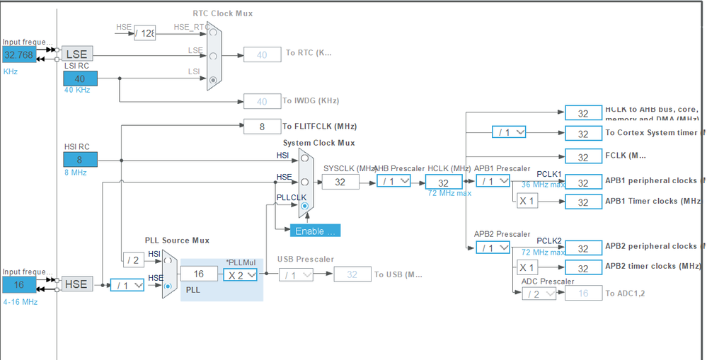

I have written the code below that I'm using to print the Hello World which I have found online. Also I do not know if their is any problem on the code. With this I have also attached the Pin Configuration and Clock configuration details below as images.

Thank you for the response. So as you have requested I have attached it below for your reference. Also I'm using Win 11 as the host system and the STM32CUBEIDE version is 1.18.0.
