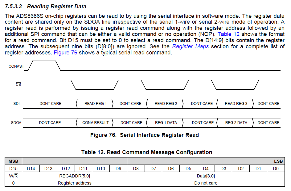

I am trying to read registers from an ADS8686S ADC from TI. It has the following timing diagram for register reads (from https://www.ti.com/lit/ds/symlink/ads8686s.pdf?ts=1624204868114&ref_url=https%253A%252F%252Fwww.ti.com%252Fproduct%252FADS8686S):
The device register is 0x10, with a supposed value of 0x2002.

// Read register device id (0x10 << 9) & 0xFF00
uint8_t tx[2] = { 0x20, 0x00 };
uint8_t rx[2] = { 0x00, 0x00 };
// Send read register command
set_adc_cs(GPIO_PIN_RESET);
HAL_SPI_TransmitReceive(&hspi1, tx, rx, 2, 1000);
set_adc_cs(GPIO_PIN_SET);
// Don't care
// Receive register result
set_adc_cs(GPIO_PIN_SET);I read back rx as { 0x00, 0x02}. Almost like I am getting half the register. Just really unsure of the issue at this point, and have been smacking my head against the wall.
