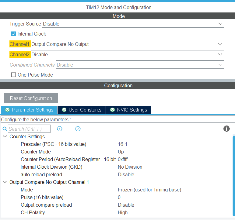

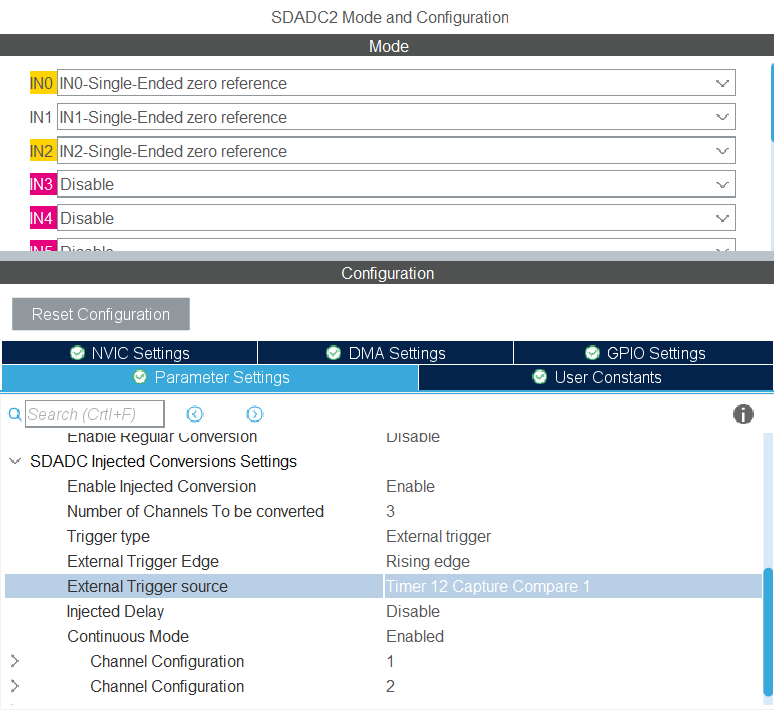

I want to create an external trigger source for SDADC 16-bit and I have selected TIM12 Capture Compare 1 as external trigger source.
Then I have enable the Output Compare, because I did not find Capture Compare.
Then I enable the NVIC for the SDADC.
HAL_TIM_Base_Start(htim13); /* TIM13 is trigger source for SDADC1 */
HAL_TIM_Base_Start(htim12); /* TIM12 is trigger source for SDADC2 */
HAL_TIM_Base_Start(htim16); /* TIM16 is trigger source for SDADC3 */
if (HAL_SDADC_InjectedStart_IT(hsdadc1) != HAL_OK)
Error_Handler();
if (HAL_SDADC_InjectedStart_IT(hsdadc2) != HAL_OK)
Error_Handler();
if (HAL_SDADC_InjectedStart_IT(hsdadc3) != HAL_OK) /* Differential only */
Error_Handler();But still. Nothing happens when I have this function avaiable.

You start the timer, but I don't see you starting the channel anywhere. Should be a call to HAL_TIM_OC_Start or similar.

If you want to trigger the SDADC using a signal coming from outside the STM32, you have to set the timer's channel to Input Capture.
Read the timer chapter in RM.

Did not work to use HAL_TIM_OC_Start(htim, TIM_CHANNEL_x)
2021-06-21 3:58 AM
By the way!
It's working now!
Mode in CubeMX need to be Toggle On Match.
