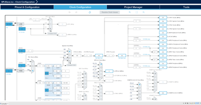

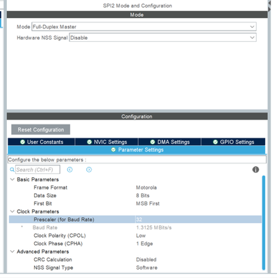

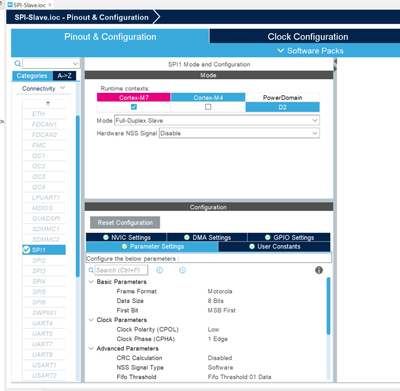

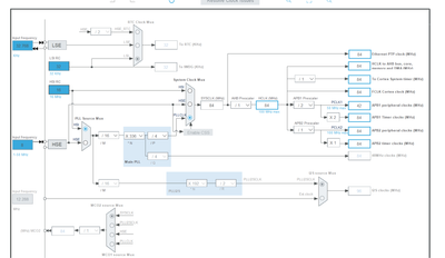

-> I have also verified based on initial code that If I stop sending data from Master to SLAVE MCU , Slave SPI doesn't receive anything, and when Master sends one byte data to Slave then only Slave receives 1 byte however its wrong byte I am receiving which is an issue I have
# Master
-> SPI Baud Rate = 1.3125 Mbps
-> Full-Duplex Master
-> Hardware control CS : Disabled
# Slave
-> Slave Peripheral Clock Frequency: 5Mz
-> Full-Duplex Slave
