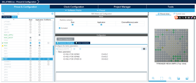

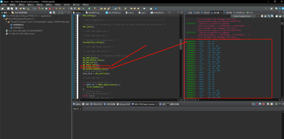

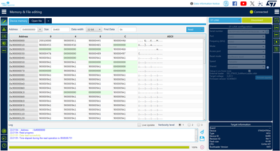

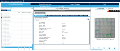

The application can be downloaded to external Flash at address 0x90000000. However, during debug startup, address 0x90000000 cannot be accessed, even though there are no errors during XSPI initialization.
Hardware Error:
Hard Fault Error The flash chip is: MX25UM25645G Set as follows

LR looks to be ASCII junk, perhaps popped off the stack.
You'll need to look at the generated CODE, and debug it

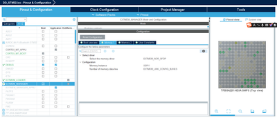

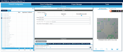

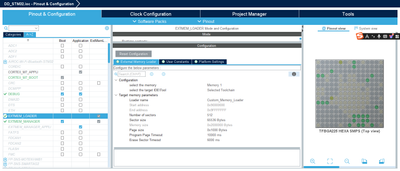

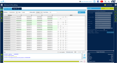

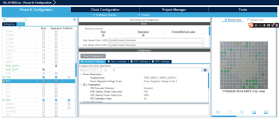

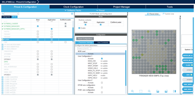

Thank you for your advice. Currently, after enabling the Flash module via the IOC configuration options, I have successfully accessed the address 0x90000000.
