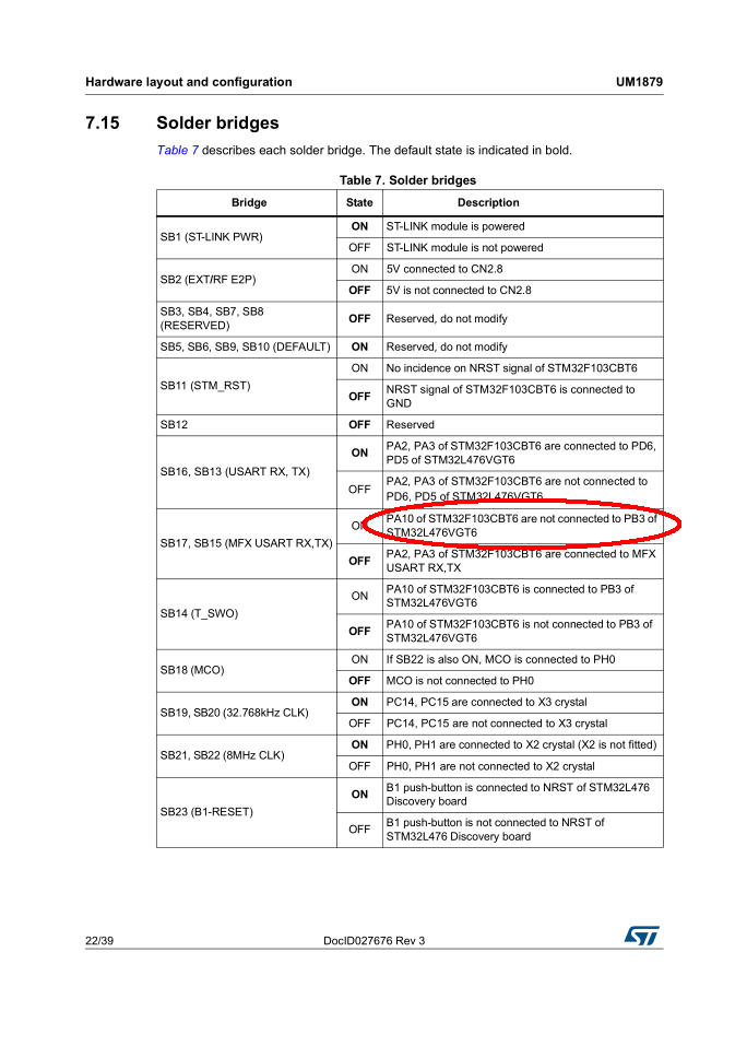

We confirm that this line in the table 7 of UM1879 Rev 3 is not correct.
It will be corrected in next revision of the document as followed:
SB17, SB15 (MFX USART RX,TX)
ON
PA2, PA3 of STM32F103CBT6 are connected to MFX USART RX,TX
OFF
PA2, PA3 of STM32F103CBT6 are not connected to MFX USART RX,TX
Best Regards,
Imen
ON
OFF
Best Regards,
Imen

I see UM1879 is in rev.4 now, with the correction as above.
Pity a complete pinout table (as in the F4 DISCO, as I mentioned above) did not make it into UM1879.
