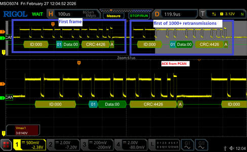

To test the setup I send dummy frames (ID: 0x000, DLC: 1, Data: 0x00). The frame is visible on the Bus and also the ACK from PCAN is visibile. PCAN USB has a 200mV higher voltage on CAN High 0 level.
Here is the dummy frame on the Oszi:
As you see on the the screenshot, the ACK is there and even though I put only one message in the Tx-Buffer of the FDCAN, it retransmitted.

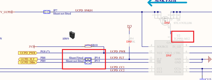

Hello @finally and welcome to the ST community,
I don't know if U2 is present in your board. In thar case you need to remove the jumpers JP14 and JP15.
Otherwise that's weird if the loopback mode has issues ..
2026-02-27 5:08 AM
Hi @mƎALLEm ,
these jumpers were removed.
