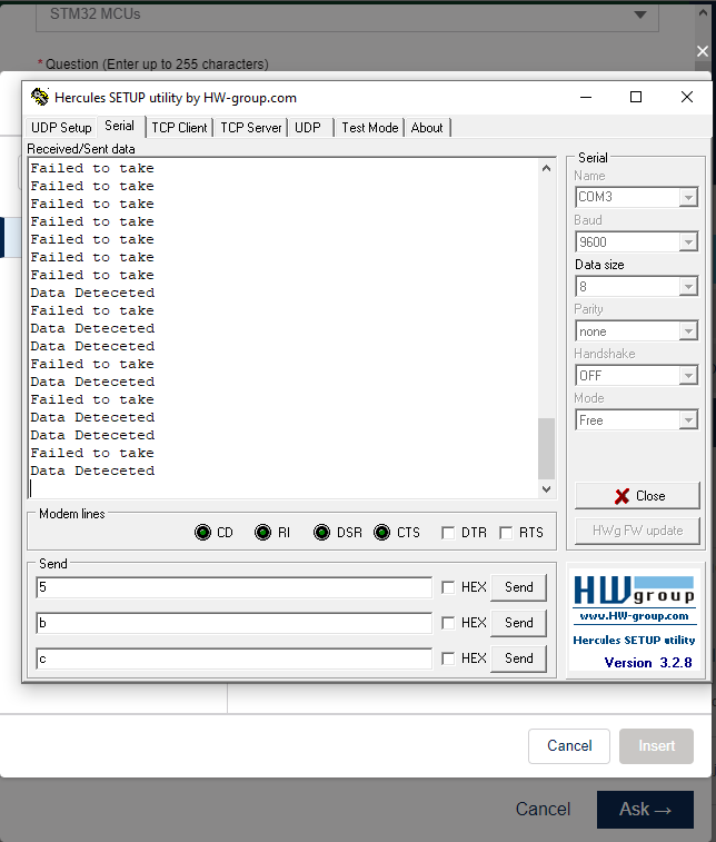

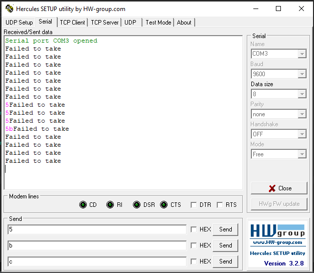

0693W00000Y9or4QAB.pngThe picture above shows that transmisson works. But receiving don't works well.
0693W00000Y9orFQAR.pngThe picture above shot when TX RX pin are shorted. Interrupts are rising.
Any idea why I can't receive data through my computer ?

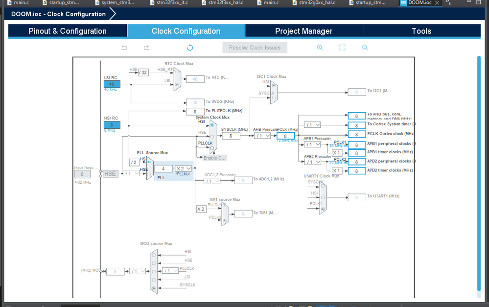

The full code and clock scheme is as follows.
