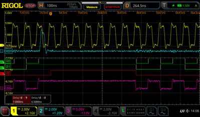

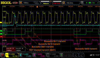

first scope trace show valid behaviour.
1. Reciever set RDY, to block one data transfer (0b01)
2. PSSI repeats the same data (0b01) at the next clock cycle and succefuly transmit them
3. PSSI succefuly sends following data (0b10)
4. PSSI succefuly sends following data (0b11)
5. PSSI set DE, indicating that following data should not be read by reciever
6. PSSI clear DE and set data to 0b00 and reciever reads them
From reciever point of view data sequence is valid (0b01->0b10->0b11->0b00), RDY is working, DE is workingValid situation

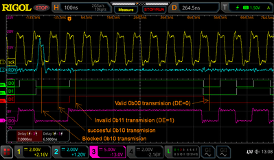

second scope trace show invalid behaviour
1. PSSI transmission of 0b10 is blocked by RDY
2. PSSI transmit the same data 0b10 at the next cycle and data is read by reciever
3. PSSI set DE and also writes next data on bus (0b11) - data is not read by the receiver (violating RM claims - red)
4. PSSI clear DE and writes next data on bus (0b00) - data is read by reciever
From rciever point of view data sequence is invalit (0b10->0b11, missing 0b11)Invalid behaviour
third scope trace show similar invalid behaviouranother invalid behaviour
Placing the RDY pulse on any (falling) edge other than the two mentioned above will not show the problem. Similar bahaviour has been observed during previous test with DMA on another chip with PDCK=60MHz. All observations are fully reproducible.

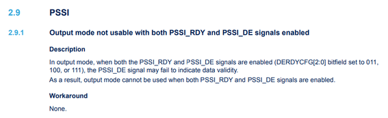

First of all, I apologize for my late reply and thank you for sharing this interesting use case and bringing this issue to our attention. This is a PSSI errata.
You can find in the Erratasheet ES0596 - Rev 8, the PSSI errata description:
You can expect the same behavior in all STM32MCUs available on the market and have PSSI interface: STM32H7R/S, STM32U5, STM32H5, STM32H7A/B...
Thank you.

Hello @Michal Dudka ;

2026-01-08 9:40 AM - edited 2026-01-08 9:40 AM
Dear @Michal Dudka ,
Thank you for identifying this new silicon erratum and for your thorough follow-up in narrowing down the use case. Your efforts enabled our teams to confirm the issue, which is now published.
As there is no workaround, future STM32 microcontrollers will benefit from an enhanced version of the same PSSI peripheral as a result of your contribution.
We would like to offer you a small symbolic gift: any STM32 board of your choice from our e-store. Please let us know your preferred board or STM32 series.
Thank you also to @KDJEM.1 for the follow-up.
