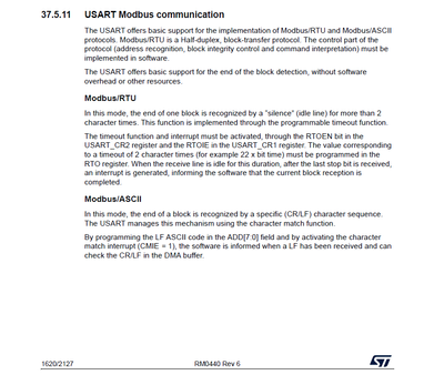

2025-05-29 12:03 PM
Your microcontroller support Modbus RTU/ASCII regarding recognize silence. Please see reference manual RM0440.
