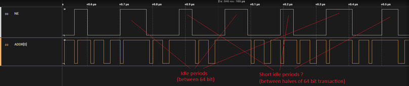

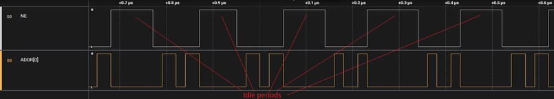

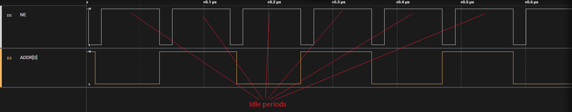

I've attached 3 captures of the address LSB and chip enable lines. The first image shows the FMC when driven by the DMA controller doing 8-bit accesses, the second shows the FMC when driven by the DMA controller doing 32-bit accesses, and the third shows the FMC when driven by the core doing 64-bit accesses (which seems to be being split into two 32-bit transactions, I assume this is a limitation of the instructions available to the core). the 32 and 64 bit accesses show that the peripheral is capable of chaining transactions back to back, but in all three captures, there's significant downtime between accesses. I was running into bandwidth limitations on the logic analyzer so these numbers are approximate, but long idle periods in these images are ~70-90ns, short idle periods in the 64-bit transaction are ~40ns.
