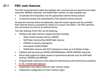

I am developing a design based on STM32N647A0 and have limitation on the number of pins to accommodate 16 data lines. The PSRAM used in STM32N6DK board is APS256XXN-OBR-BG and is based on 16 data lines. So, can i use APS6408L-3OBM-BA, PSRAM that has 8 data lines because of the limitation of number of pins. This will help me to stay with the STM32N647A0 part number? Please suggest on this.
Also, I understand the data rate may be compromised by using APS6408L-3OBM-BA, but I want your suggestion, if the STM32N647A0 device will be compatible to work with 8 data lines PSRAM.

8 bit data width is supported by the device.
Please refer to the reference manual RM0486
But, depending on your application it can impact the application performance. I don't recommend 8-bit mode for graphical purpose for example.
Hope that I answered your question.
