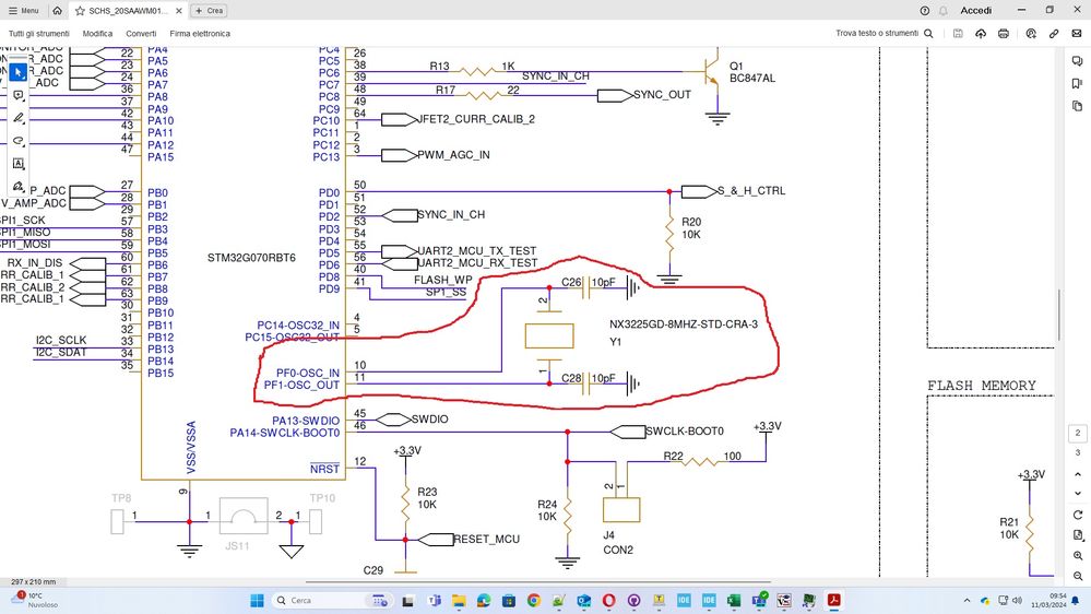

The external clock board schematic is:

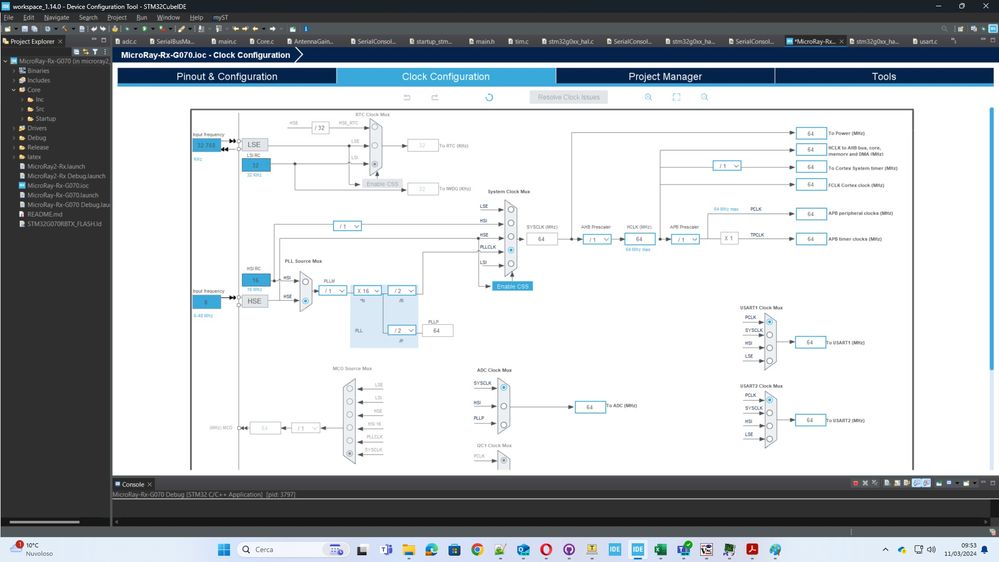

Clock configuration is:

@Beppe101 You showed in your schematics that you are using a crystal connected to OSC_IN and OSC_OUT, right?
Then you configure the HSE to BYPASS Clock Source, which does not expect a crystal, but an external oscillator connected to OSC_IN.
So if you want to work with a crystal at OSC_IN/OSC_OUT, you have to set the HSE option to Crystal/Ceramic Resonator, as @Sarra.S already wrote.

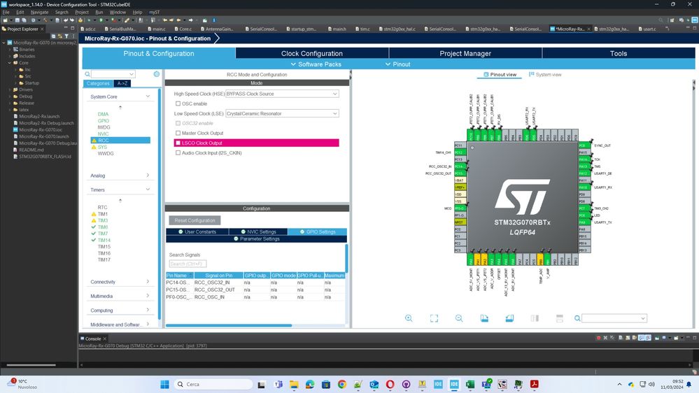

This is likely caused by misconfiguring the HSE clock, if HSE is selected as the clock source in the clock configuration, under the Pinout & Configuration tab select crystal/ceramic Resonator in the high-speed clock (HSE).
if you're supplying your clock to the MCU's RCC_OSC_IN pin, then select the BYPASS Clock Source option.

thanks for your answer, as shown in picture above I selected BYPASS_Clock_Source but this does not work as expected.
What could be the reason for issue ?
