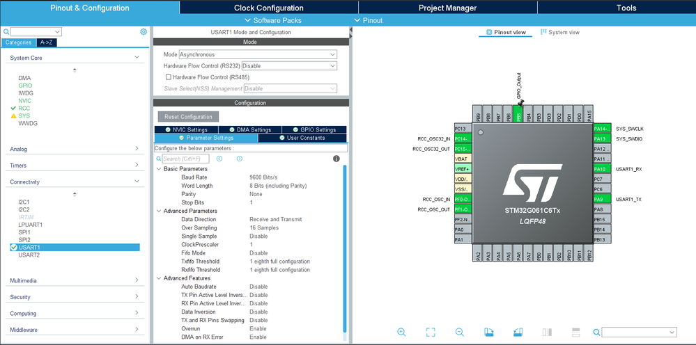

I am using a STM32G061C6T6 MCU. I'm trying to contact Nextion HMI. My data sending is successful, but I can't get any data. I couldn't run any of the Pooling and interrupt methods when receiving data. When I follow the RX pin with the oscilloscope, the data comes, but I can't read it with MCU.
I tried the display on the Nucleo-F103RB card with a simple HAL code. I can read the data from the screen. Do I need to do a special operation on this MCU(STM32G061C6) to be able to read with UART? I'd appreciate it if you could help me.

Hello @Fatih Erdoğan
Do you have the floowing line of code in bold in stm32g0xx_hal_msp.c ?
/**USART1 GPIO Configuration
PA9 ------> USART1_TX
PA10 ------> USART1_RX
GPIO_InitStruct.Pin = GPIO_PIN_9|GPIO_PIN_10;
GPIO_InitStruct.Alternate = GPIO_AF1_USART1;
If not, please add it.
BR,
Bruno

Hi @Bruno_ST ,
I'm grateful to you, the problem is solved. Thank you very much.
