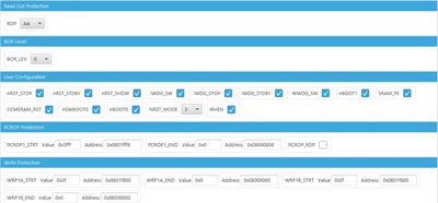

I have already check the OB. It is the same as the virgin new board.
It looks like there is something else causing the programmed board having difficulty to start communication with the UART bootloader.
