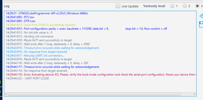

2025-11-17 6:32 AM
I have captured the log as follows.
14:29:31 : STM32CubeProgrammer API v2.20.0 | Windows-64Bits
14:29:41:895 : RTS low
14:29:41:895 : DTR Low
14:29:41:913 : Serial Port COM3 is successfully opened.
14:29:41:913 : Port configuration: parity = even, baudrate = 115200, data-bit = 8, stop-bit = 1.0, flow-control = off
14:29:41:913 : No Init bits value is : 0
14:29:41:913 : Sending init command:
14:29:41:919 : #byte 0x7F sent successfully to target
14:29:43:915 : Wait ends after 1 loop, dataready = 0, delay = 2000
14:29:43:916 : Timeout error occured while waiting for acknowledgement.
14:29:43:916 : No response from target received
14:29:43:917 : Retrying UART init connection...
14:29:43:918 : #byte 0x7F sent successfully to target
14:29:44:116 : Wait ends after 2 loop, dataready = 0, delay = 200
14:29:44:117 : Timeout error occured while waiting for acknowledgement.
14:29:44:118 : No response from target received
14:29:44:118 : Error: Activating device: KO. Please, verify the boot mode configuration and check the serial port configuration. Reset your device then try again...
14:29:44:222 : UART PORT CLOSE
