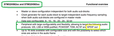

asking AI about this: is SAI spdif output avail in H563 serie ?
The STM32H563 series supports SPDIF output via its Serial Audio Interface (SAI) peripheral. Both SAI1 and SAI2 blocks on STM32H563xx devices are capable of SPDIF output when configured as transmitters.
Yes, the STM32H563 series supports SAI SPDIF output on both SAI1 and SAI2 blocks, but only in transmitter mode. Configuration requires setting the SAI to SPDIF mode with specific register settings, and there are some limitations such as fixed data size and use of only the SD line.

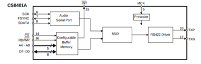

As spdif transmitter i already used CS8401 and expected similar function, as a real spdif transmitter:
So the spdif output on SAI is just a serial output using biphase mark code , the channel status etc you have to puzzle together ... 192 times, to get a valid frame block.
Your right, i just was disappointed by the "low level" spdif transmitter.
