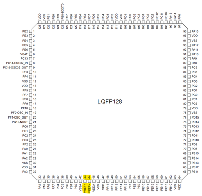

When I first glanced through the STM32G474 datasheet, I saw VREF+ and VREF- on pins 43 and 44 on the LQFP128 package. "Cool", I thought, although I had no significant need for an actual VREF- pin.
However, when I was making a schematics symbol, I noticed that the two pins are in fact VREF+ and VREF+. Apparently, the exact same thing on two pins next to each other.
Does anyone know why this is? It makes perfect sense to have multiple pins for supply voltage and ground. But for a reference voltage? I have found no explanation in the datasheet or the reference manual.

Edit: added screenshot

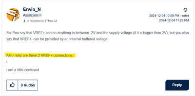

Yes. At least the link I provided works at my place. Erwin_N asks the question in the very last post in the thread:

I have already shared a screenshot of the pin definitions table, but I am happy to share one of the package itself.
