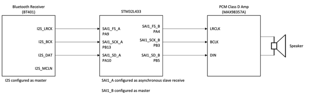

Below is the setup...
The I2S amplifier (MAX98357A) seems to work fine with the 12.288MHz clock generated by the internal MSI RC and PLL.
But the BT401 either requires multiple attempts to start playing and sometimes plays just a screeching sound for a few seconds then stops. So I need to rule out whether the issue is caused by clock jitter by trying a more accurate clock source.

Its probably confusing as I am showing scope captures of when the BT401 is a master and also a slave.
The scope capture you are referring to (titled MASTER) is in fact when the BT401 was the master and the STM32 was the slave. In this configuration, the MCLK is generated by the BT401 but is not used by the STM32 or the amp (its just captured on the scope for reference).
But I have since changed the configuration for the BT401 to be the slave, which is when I started having isssues with playback with the BT401. When the BT401 is in slave mode, it only ouputs data on the SD pin. But to do this it needs a BCLK and LRCLK, which is provided by the STM32. MCLK is not needed by the BT401 in slave mode, it only needs BCLK and LRCLK.

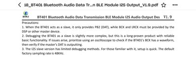

2025-12-27 12:13 AM
@freeflyer wrote:MCLK is not needed by the BT401 in slave mode, it only needs BCLK and LRCLK.
Show doc where is this defined.
2025-12-27 12:45 AM
I have also confirmed this with my contact in china who supplies the boards/chips/firmware
2025-12-27 2:24 AM

2025-12-27 2:56 AM
I dont see one word about MCLK not required...
