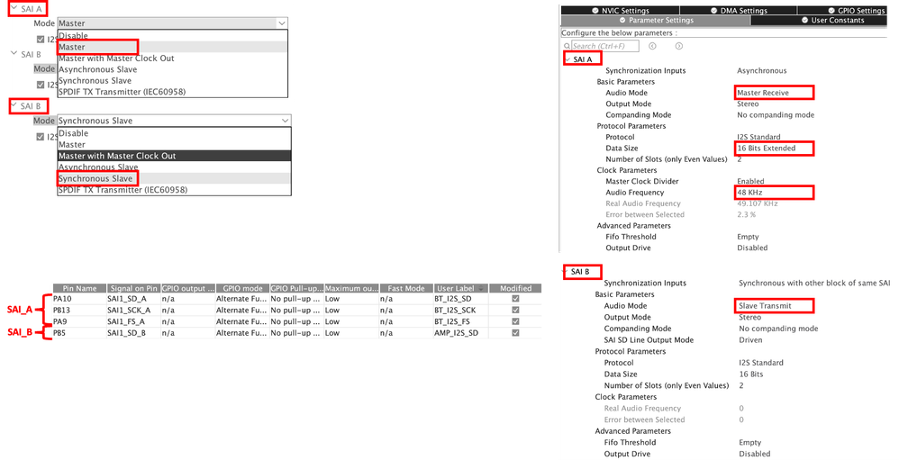

Below is the SAI configuration...

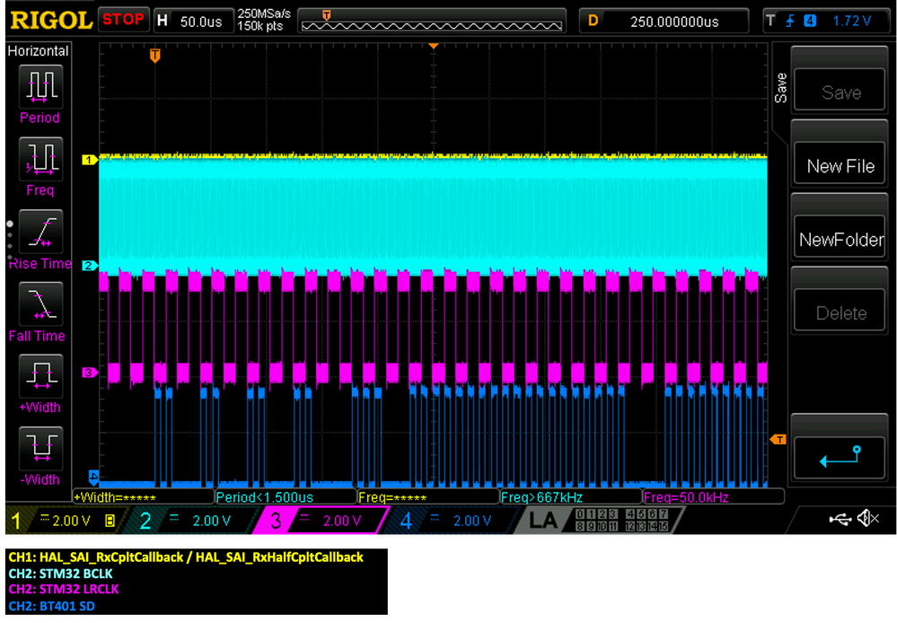

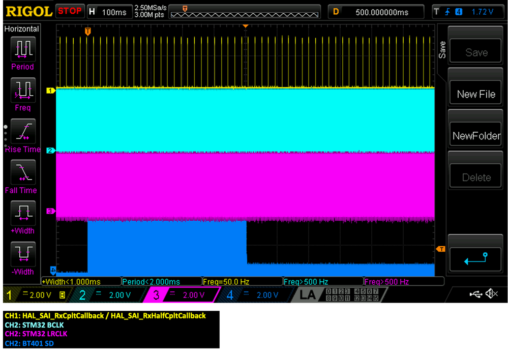

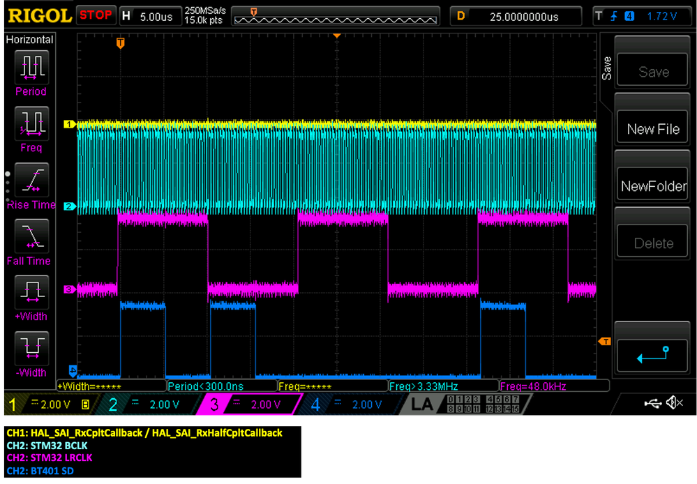

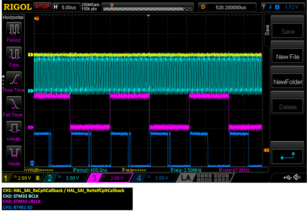

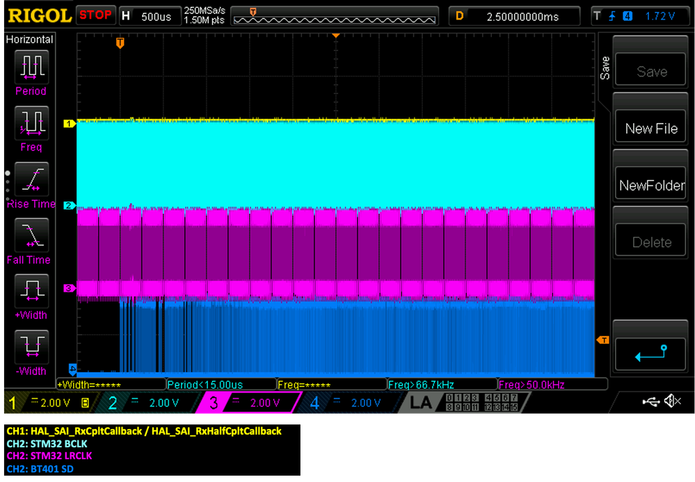

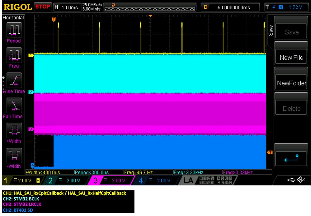

I have attached some scope captures when the BT401 is slave and the STM32 is master, but I don’t think it tells you much ?
The scope was set to a single trigger on the rising edge of the BT401 SD output (CH4) i.e. when audio is intially played from the phone.
The BCLK and LRCLK generated by the STM32 are on CH 2 and CH3 respectively.
CH1 is set for the duration of the I2S DMA interrupts (HAL_SAI_RxCpltCallback & HAL_SAI_RxHalfCpltCallback).
The BT401 should output data when the phone plays the audio so long as it has the bit clock and left/right clock from the STM32. Even iif the data output pin (SD) was not connected to anything, you should still see data out.
But as you can see from the scope captures, the initial data is corrupt and after a very short time the data just stops (as shown in the last scope capture when it stops after ~500ms). After several attempts of trying to play, the BT401 seems to reset all its settings because the bluetooth connection is lost and it has to be removed from the phone and added again (this also requires a power reset of the BT401).
So the issue is to do with the BT401, but I don't know what the issue is. Its not due to clock drift as I already proved that by using an oscillator. The STM32 firmware is working correctly, its just that the BT401 does not behave when its in slave mode.

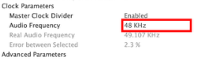

Hi , some hints 1. module irelevant slave or master use own clk .
2. you have fails in config start with here
audio systems never will work with 2,3% error in clk.
3. Your cyan scoped BCLK seems clock 24 bit instead 16 , that require BT401
4. Using HAL and MX for this isnt optimal way, sometimes impossible. As you see with not working ext clk.
After you correct mistakes i mean slave can work as you plan.

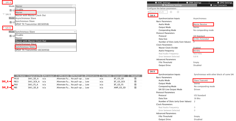

2025-12-25 12:22 PM
Ahh I see, sorry I did not clearly understand your suggestiion.
So you are saying that....
If I can get that configuration to work then it will meet my requirements, because then the BT401 will behave (unlike misbehaving when its in slave mode) and the voice prompts will play regardless of the BT401 state.
Is this what the configuraton would look like....

2025-12-25 12:33 PM
Apologies, that screnshot I posted was an older version which had the incorrect clock configuration so the SAI showed an error with the 48kHz audio frequency as you pointed out.
Since managing to achieve 12.288MHz for the SAI clock, the audio clock is now correct with no error....

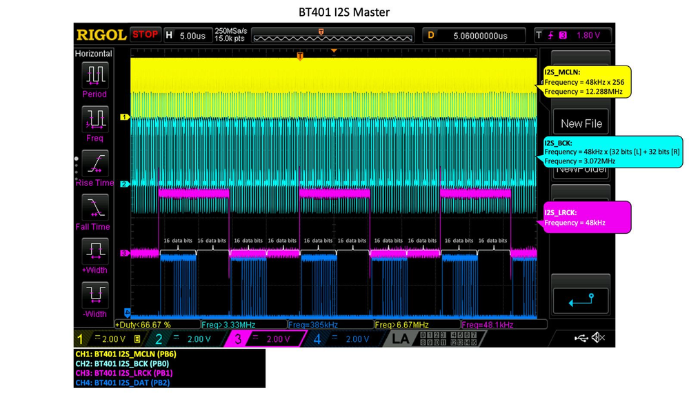

The BT401 uses 32-bit data frame but only sends 16-bit date...
The BT401 outputs 16-bit audio data packaged in a 32-bit I2S frame format. The BCK frequency of 3.072 MHz (48 kHz × 64 bits per frame) confirms this 32-bit-per-channel transmission structure.
Are you suggesting I should be using low level rather than HAL and CubeMX ? Is this due to HAL being too slow or bugs ?
2025-12-25 12:57 PM
Configuration...you understand now. :)
Callbacks ...only the transmit are to handle, as we want play audio. At first .
The receive callbacks...forget , for now. BT receive will run , but we dont use it.
Except, later, if it looks "ok" , then we copy in the (transmit) callbacks not zeros for silence, or "voice" for info, but also then one of the input buffers , to "copy" the input from BT to the play buffer.
(Synchronisation is at first not important, we do it later. Get it working at first, even if BT audio might have some dropouts...or else, not important now. )
We create two independent streams : the important, L433 is master, to play to the dac.
The second, from BT , might run...musik, or not...silence. But output always possible, and voice clear.
