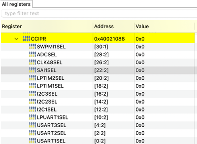

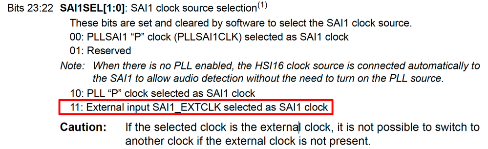

__HAL_RCC_GET_SAI1_SOURCE() reads the register RCC->CCIPR and I can see SAI1SEL is 0x0...

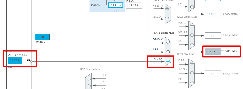

So why is SAI1SEL not set to '11' as shown in the refernce manual...
I've selected it CubeMX....
UPDATE: I set a breakpoint in the function RCCEx_GetSAIxPeriphCLKFreq and manually changed the value of SAI1SEL from 0x0 to 0x3 and the SCK and FS now work and the BT audio plays.

I found the reason why the SAI EXT CLOCK was not being configured.
The generated code in the file stm32l4xx_hal_msp.c configures all the periperhal clocks.
When initialising each peripheral, the clock selection is defined by PeriphClkInit.PeriphClockSelection.
But for some reason, when initialising the SAI peripheral (HAL_SAI_MspIni) there is no value assigned to PeriphClkInit.PeriphClockSelection
A value is assigned to PeriphClkInit.Sai1ClockSelection (RCC_SAI1CLKSOURCE_PIN) but because PeriphClkInit.PeriphClockSelection is zero the SAI clock peripheral never gets configured
So I manually added the line (for SAI block B)...
PeriphClkInit.PeriphClockSelection = RCC_PERIPHCLK_SAI1;
So is this a bug ? All other periphals (e.g. USB, UART, I2C etc) are assigned with a value for PeriphClkInit.PeriphClockSelection with the exception of the SAI.
HAL_SAI_MspIni is shown below (with my manually added line for block B)...
