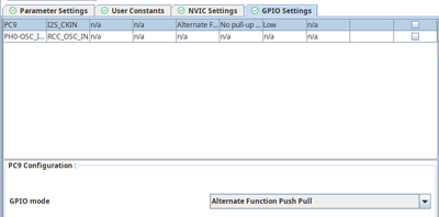

Strange...

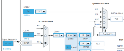

but AF setting is same, i tried on my H743 here, ext clk for SAI / I2S :
2025-12-23 1:25 PM

2025-12-23 2:12 PM
Yes it is very strange I don’t understand why it’s not working. It gives you the option to use an external clock source, but when I configure and use an external clock it seems to ignore it.
The waveform shown on the scope seems ok ? The edges are rounded but that’s due to the scope probe capacitance. I could adjust the screw on the probe but it will never have nice square edges.

2025-12-24 2:02 AM - edited 2025-12-24 2:09 AM
Ok, so :
- L433 can be master, BT401 can work as slave
- 12.288 oscillator should be the clock
-> we use the 12.288 oscillator as HSE bypass
- set PLL for core to ...12 /4 --- PLL x 50 /2 = 76.8 M for core
- set PLL for SAI ...12 /4 --- PLL x 16 /4 = 12.288 , set 48kHz audio
Then all should work, as you want it.
(here on H743 , should be almost same on your L433 )

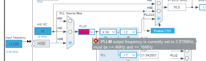

2025-12-24 4:39 AM
This is turning into a nightmare, I dont understand why the SAI external clock wont work.
I tried configuring the clocks to use HSE like you suggested but get an error...
2025-12-24 4:57 AM
Come on...so set PLLM /4 -> /2 and the output divider /2 -> /4 , to respect, what are the constraints of the PLL , Cube is telling you.
This might be different on different chips...so just adjust it , to match it for your L433 .

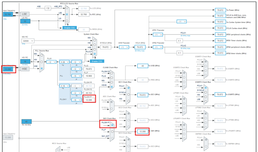

2025-12-24 5:33 AM - edited 2025-12-24 7:25 AM
Sorry AScha.3 I am just getting super frustrated with this, I've ploughed lots of work into this project and the firmware is 99% complete with all the functionality I require, but this last 1% (issue with Bluetooth playback) risks writing the whole project off.
The good news is that I managed to configure the clock to use the 12.288MHz oscillator as HSE and the SAI also runs from the oscillator....
The bad news is the issue with the bluetooth audio playback still exists, so after all that it seems the clock source (internal MSI RC or external oscillator) is not the issue.
