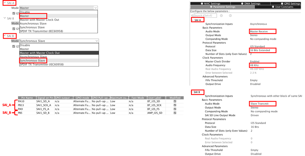

When we last discussed this, I had the BT401 as a master I2S and the STM32 as a slave I2S.
However, I had to swap this around because the BT401 I2S clocks were intermittent at powerup which meant the voice prompt (stored in external flash connected to the STM32 via SPI with DMA) which is called at power up stuttered.
In fact its a better solution to use the STM32 as the I2S master, because it removes dependancy on the BT401 to generate the I2s clocks. This means that the voice prompts (which are critical to the system) will work even if the BT401 fails for some reason.
The STM32 outputs the bit clock and left/right clock to the BT401 and amplifier, the BT401 outputs data to the STM32 and the STM32 outputs data to the amplifier.
Below is the SAI configuratoin which should align with the block diagram...
This is all working correctly, other than the issue with playing audio from the BT401.

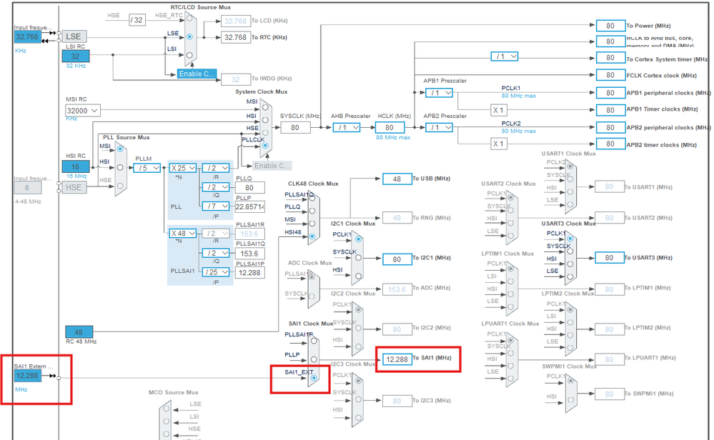

I have fitted the ASFL1-12.288MHZ-EC-T but the STM32 is no longer generating the I2S clocks (bit clock & left/right clock) so my I2S audio has completely stopped working :(
The output of the ASFL1 is connected to pin PA0 of the STM32.
In CubeMX I enabled SAI Extern clock...
The SAI clock is configured to use SAI EXT...

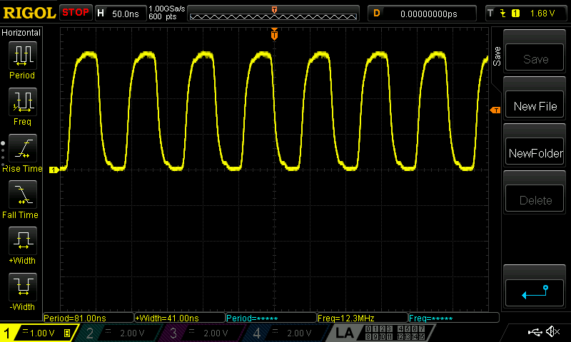

I have checked the 12.288MHz output on a scope....

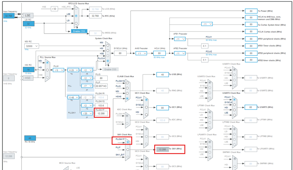

For reference, below is the clock configuration when I2S did work (with the exception of the BT issues). This is when I used the internal MSI RC to generate the 12.288MHz clock...
The only thing that has changed is the SAI clock source, instead of using the internal MSI RC it is using the external SAI pin.
So why does it not work with the external SAI 12.288MHz clock ?

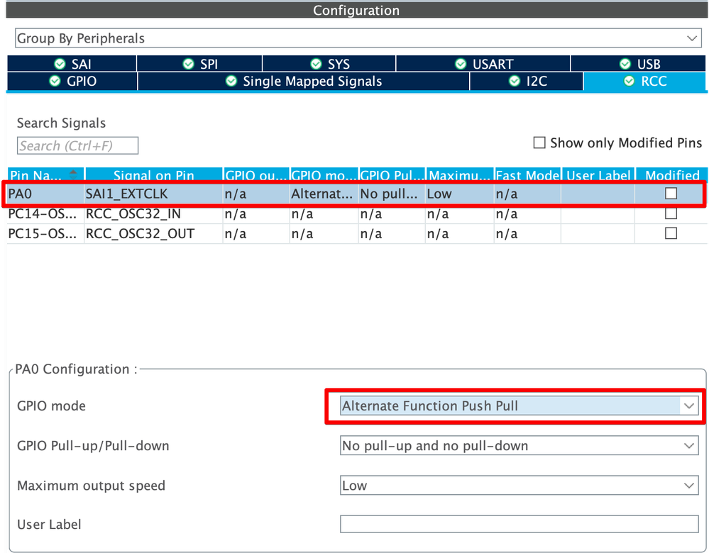

Is this a clue ?
If so it makes no sense, because it implies that SAI_EXTCLK on pin PA0 is an output due to the fact the GPIO mode is push/pull....
So if its an output, how can it be used to clock the SAI peripheral ???

Really only switching the clock mux to sai_ext ? It should work as before.
Switching back to pll_sai ...working then ?

Correct, it does not work with the SAI1_EXTCLK input. I even put the scope directly on the STM32 pin PA0 to make sure the clock was there.
I looked at the bit clock and left/right clock on the scope and there was nothing there.
if I revert back to the internal MSI RC as the clock source for SAI it generates the bit clock and left/right clock and plays the audio.
it just does not seem to accept the external clock for some reason.
