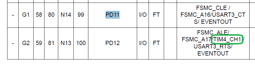

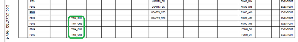

I need to ask you one more thing to understand how the things work. If I make these edits:GPIO_InitStructure.GPIO_Pin = GPIO_Pin_11 | GPIO_Pin_13 | GPIO_Pin_14 | GPIO_Pin_15;
GPIO_InitStructure.GPIO_Mode = GPIO_Mode_AF;
GPIO_InitStructure.GPIO_Speed = GPIO_Speed_100MHz;
GPIO_InitStructure.GPIO_OType = GPIO_OType_PP;
GPIO_InitStructure.GPIO_PuPd = GPIO_PuPd_UP ;
GPIO_Init(GPIOD, &GPIO_InitStructure);
/* Connect AF to TIM4 pins */
GPIO_PinAFConfig(GPIOD, GPIO_PinSource11, GPIO_AF_TIM4); // Green
GPIO_PinAFConfig(GPIOD, GPIO_PinSource13, GPIO_AF_TIM4); // Orange
GPIO_PinAFConfig(GPIOD, GPIO_PinSource14, GPIO_AF_TIM4); // Red
GPIO_PinAFConfig(GPIOD, GPIO_PinSource15, GPIO_AF_TIM4); // Blue
using the
GPIO_PinSource11
rather than
GPIO_PinSource12
on PD11 I am not able to see anything. What is the reason?
Thank you for your help. Pablo2013-10-02 7:50 AM
The problem is that you're inventing connectivity that doesn't exist. From the Data Manual for the STM32F40x devices2013-10-03 8:49 AM
Thanks a lot clive,
that's exactly what I was looking for.Regards,PabloWe’re moving the ST Community to a new platform to give you a better and more reliable community experience.
