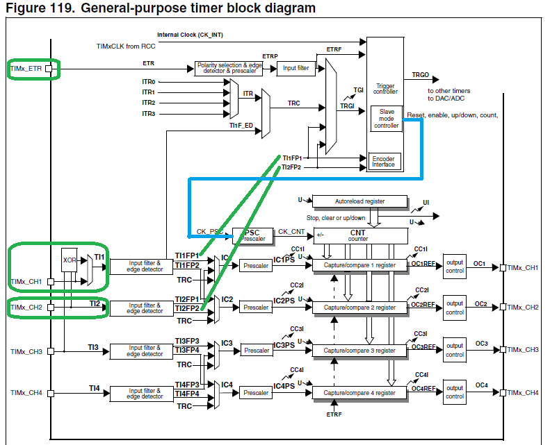

Could someone explain me how external clock for timer is done. Specially I don't understand how TI1, TI2 etc., are mapped to the physical pin. Alternate function on GPIO is mapped to different timers but is it the TIx pins? Thanks John #external-clock-timer-ti2-ti12013-08-13 8:59 AM
