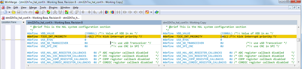

I just added two DMA channels to UART1 and noticed a change in stm32h7xx_hal_conf.h The project uses LwIP and FreeRTOS. FreeRTOS relies on TIM6 as a system timer. I can understand when SysTick has the highest priority. But I can't understand why set it to the lowest in the system? Further, it is not clear why the priority changed again to the maximum?

TICK_INT_PRIORITY is textual constant, #define in HAL header stm32h7xx_hal_conf.h (look at first post picture). STM32Cube determines and completely overwrites its textual value during code generation (or refresh, keeping user code) phase. Indeed, should not happen or at least need explanation :grinning_face:
