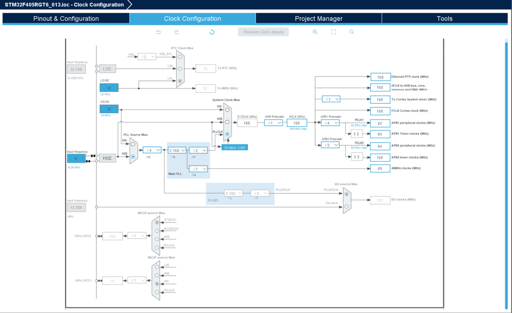

We have STM32F405RGT6 and we want to implement DAC through DMA.
We used an example for STM32F429ZI-Nucleo
Here is an actual code where we have an underrun the error and we need help to clarify reason and find a solution, thanks!:

uint32_t timer_clock_frequency = 0; /* Timer clock frequency */
uint32_t timer_prescaler = 0; /* Time base prescaler to have timebase aligned on minimum frequency possible */
uint32_t timer_reload = 0; /* Timer reload value in function of timer prescaler to achieve time base period */
if (LL_RCC_GetAPB1Prescaler() == LL_RCC_APB1_DIV_1)
timer_clock_frequency = __LL_RCC_CALC_PCLK1_FREQ(SystemCoreClock, LL_RCC_GetAPB1Prescaler());
else
timer_clock_frequency = (__LL_RCC_CALC_PCLK1_FREQ(SystemCoreClock, LL_RCC_GetAPB1Prescaler()) * 2);
timer_prescaler = ((timer_clock_frequency / (WAVEFORM_TIMER_PRESCALER_MAX_VALUE * WAVEFORM_TIMER_FREQUENCY_RANGE_MIN)) +1);
timer_reload = (timer_clock_frequency / (timer_prescaler * WAVEFORM_TIMER_FREQUENCY));
LL_APB1_GRP1_EnableClock(LL_APB1_GRP1_PERIPH_TIM6);
LL_TIM_SetPrescaler(TIM6, (timer_prescaler - 1));
LL_TIM_SetAutoReload(TIM6, (timer_reload - 1));//83
LL_TIM_SetCounterMode(TIM6, LL_TIM_COUNTERMODE_UP);
LL_TIM_SetTriggerOutput(TIM6, LL_TIM_TRGO_UPDATE);
LL_TIM_EnableCounter(TIM6);

void SystemClock_Config(void)
LL_FLASH_SetLatency(LL_FLASH_LATENCY_5);
while(LL_FLASH_GetLatency()!= LL_FLASH_LATENCY_5)
LL_PWR_SetRegulVoltageScaling(LL_PWR_REGU_VOLTAGE_SCALE1);
LL_RCC_HSE_Enable();
while(LL_RCC_HSE_IsReady() != 1)
LL_RCC_PLL_ConfigDomain_SYS(LL_RCC_PLLSOURCE_HSE, LL_RCC_PLLM_DIV_4, 168, LL_RCC_PLLP_DIV_2);
LL_RCC_PLL_ConfigDomain_48M(LL_RCC_PLLSOURCE_HSE, LL_RCC_PLLM_DIV_4, 168, LL_RCC_PLLQ_DIV_7);
LL_RCC_PLL_Enable();
while(LL_RCC_PLL_IsReady() != 1)
while (LL_PWR_IsActiveFlag_VOS() == 0)
LL_RCC_SetAHBPrescaler(LL_RCC_SYSCLK_DIV_1);
LL_RCC_SetAPB1Prescaler(LL_RCC_APB1_DIV_4);
LL_RCC_SetAPB2Prescaler(LL_RCC_APB2_DIV_2);
LL_RCC_SetSysClkSource(LL_RCC_SYS_CLKSOURCE_PLL);
while(LL_RCC_GetSysClkSource() != LL_RCC_SYS_CLKSOURCE_STATUS_PLL)
LL_SetSystemCoreClock(168000000);
if (HAL_InitTick (TICK_INT_PRIORITY) != HAL_OK)
Error_Handler();

LL_GPIO_TogglePin(GPIOB, LL_GPIO_PIN_2);
LL_mDelay(period);
void Debug_Check_Timers(void)
if (!LL_TIM_IsEnabledCounter(TIM6))
Debug_LED_Blink(3, 200);
void Debug_Check_DMA(void)
if (!LL_DMA_IsEnabledStream(DMA1, LL_DMA_STREAM_5))
Debug_LED_Blink(2, 500);
void Debug_Check_DAC(void)
if (!LL_DAC_IsEnabled(DAC1, LL_DAC_CHANNEL_1))
Debug_LED_Blink(5, 100);
void Error_Handler(void)
__disable_irq();
while (1)
#ifdef USE_FULL_ASSERT
#endif /* USE_FULL_ASSERT */
stm32f4xx_it.c:
#include "main.h"
#include "stm32f4xx_it.h"
extern PCD_HandleTypeDef hpcd_USB_OTG_FS;
void NMI_Handler(void)
while (1)
void HardFault_Handler(void)
while (1)
void MemManage_Handler(void)
while (1)
void BusFault_Handler(void)
while (1)
void UsageFault_Handler(void)
while (1)
void SVC_Handler(void)
void DebugMon_Handler(void)
void PendSV_Handler(void)
void SysTick_Handler(void)
HAL_IncTick();
void DMA1_Stream5_IRQHandler(void)
/* USER CODE BEGIN DMA1_Stream5_IRQn 0 */
/* Check whether DMA transfer error caused the DMA interruption */
if(LL_DMA_IsActiveFlag_TE7(DMA1) == 1)
/* Clear flag DMA transfer error */
LL_DMA_ClearFlag_TE7(DMA1);
/* Call interruption treatment function */
DacDmaTransferError_Callback();
/* USER CODE END DMA1_Stream5_IRQn 0 */
void TIM6_DAC_IRQHandler(void)
// if (LL_TIM_IsActiveFlag_UPDATE(TIM6)) {
// Debug_LED_Blink(100, 100);
// LL_TIM_ClearFlag_UPDATE(TIM6);
/* USER CODE BEGIN TIM6_DAC_IRQn 0 */
/* Check whether DAC channel1 underrun caused the DAC interruption */
if(LL_DAC_IsActiveFlag_DMAUDR1(DAC1) != 0)
if (LL_DMA_GetDataLength(DMA1, LL_DMA_STREAM_5) == 0)
Debug_LED_Blink(3, 200); // Blinks 3 times if DMA is not transferring data
if (!LL_TIM_IsEnabledCounter(TIM6)) {
Debug_LED_Blink(4, 300);
if (LL_TIM_GetCounter(TIM6) == 0)
Debug_LED_Blink(4, 300); // Blinks 4 times if TIM6 is not counting
Debug_LED_Blink(5, 100); // Blinks 5 times if DAC is not enabled
Debug_LED_Blink(3, 200); // DMA not transferring
Debug_Check_Timers();
Debug_Check_DMA();
Debug_Check_DAC();
/* Clear flag DAC channel1 underrun */
LL_DAC_ClearFlag_DMAUDR1(DAC1);
DacUnderrunError_Callback();
/* USER CODE END TIM6_DAC_IRQn 0 */
/* USER CODE BEGIN TIM6_DAC_IRQn 1 */
/* USER CODE END TIM6_DAC_IRQn 1 */
void OTG_FS_IRQHandler(void)
HAL_PCD_IRQHandler(&hpcd_USB_OTG_FS);
2025-03-12 11:52 AM
