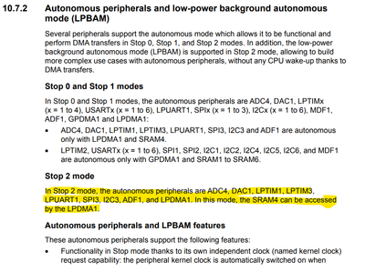

Hello @caiChangKun
Several peripheral support the autonomous mode and can run in STOP mode without CPU wakeup. Please refer to the reference manual:
So you don't need to reinitialize these peripheral.
Below is typical sequence for entering and exiting STOP2 with FreeRTOS:
