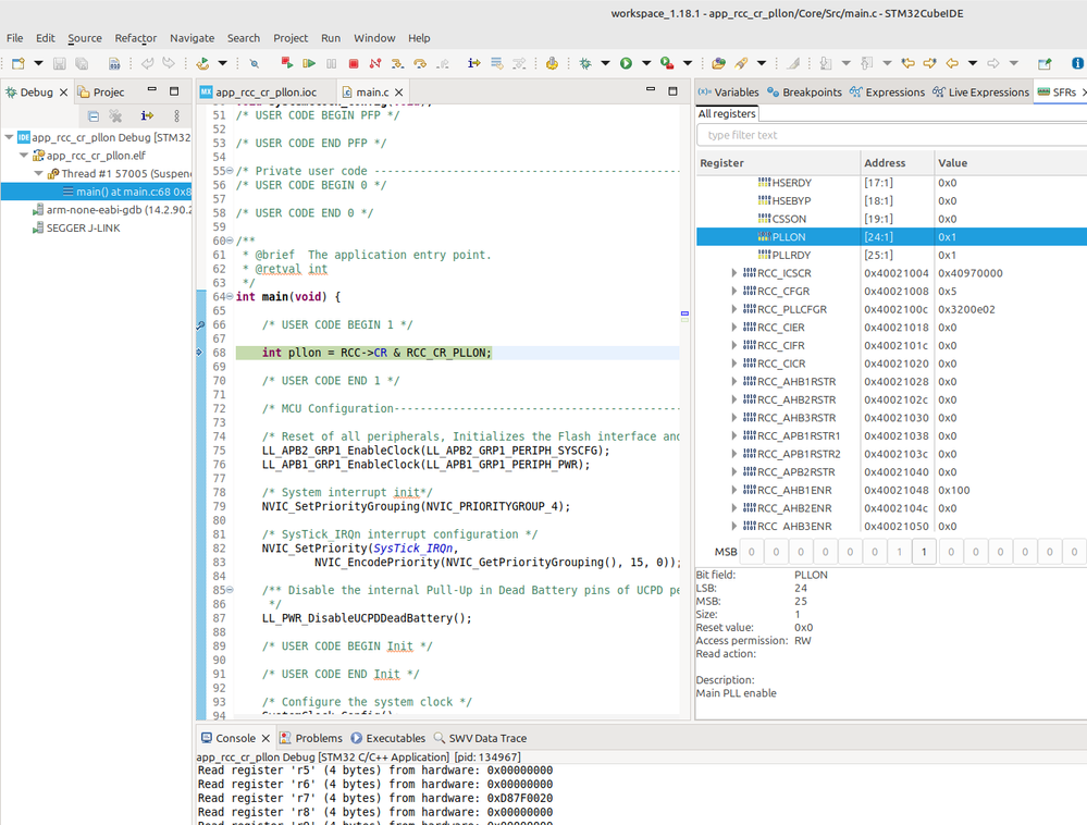

I worked with LL years ago and didn’t encounter this issue back then, so I started wondering what’s going on now.
Previously, I mainly used Nucleo boards, and everything worked fine. But now I’m using a custom board with a J-Link debugger, and the debug interface only uses SWDIO and SWDCLK. It seems that a software reset doesn’t fully restore all registers. So when I start a new debug session without triggering a hardware reset via NRST, the PLL is still running from before. As a result, SystemClock_Config doesn’t properly reconfigure the PLL.

I also checked the Ozone debugger with the same J-Link, and there is a much higher chance that RCC_CR.PLON gets reset after starting debugging and performing a reset. However, sometimes it still remains ON...
No time to dig it more. But maybe it may be useful for someone else.

2025-07-16 6:42 AM
Hello @Ghofrane GSOURI,
For debugging, I use a J-Link with only two lines: SWDIO and SWDCLK—no NRST. This issue cannot be reproduced with an ST-Link.
On the other hand, when debugging the same program using Segger Ozone, the debugger fails to clear the PLLON bit on the first connection. However, after each subsequent download, PLLON is properly reset.
A simple modification in SystemClock_Config can mitigate this issue. I believe most boards only expose SWDIO and SWDCLK, and when using a J-Link, this situation can be quite common if the PLL is enabled without being explicitly disabled beforehand.
