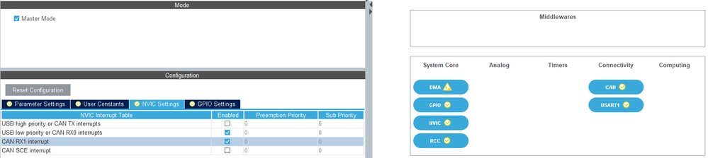

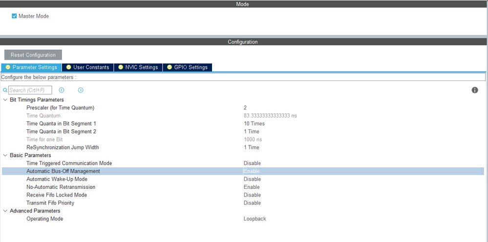

2020-06-29 4:18 AM
There are 2 interesting things happening :
#1 : Without enabling CAN_Transmit_IT , HAL_CAN_TxMailbox0CompleteCallback() function gets called.
#2 : And then, code gets stuck in the (HAL_CAN_RxFifo0MsgPendingCallback) function even if I am not transmitting in callback function and clearing the buffer.
I am pretty sure, it is not a programming bug. There may be 2 areas of bug :

2020-06-29 10:09 AM
2020-06-29 4:01 PM
Thanks man,
These settings worked. I appreciate for your time and effort you put to help me out.
Regards,
Alankrit
