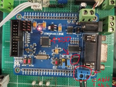

Yes. It's not actually a Blue Pill. But that kit uses the same chip (STM32F103C8T6) as Blue Bill. The kit includes transceiver A1050. PB8 and PB9 are used for CAN_RX and CAN_TX pins. When I use PA11 and PA12, it's still OK. But when remapping to PB8 and PB9 with the same code, it gets stuck, as I said.
2026-01-12 12:50 AM
In next time please use </> button to share your code:
1- Did you modify the hardware on the board to connect the new CAN pins to the transceiver? if yes how you did that?
2- Share the schematics of the board and tell what you have modified on it?

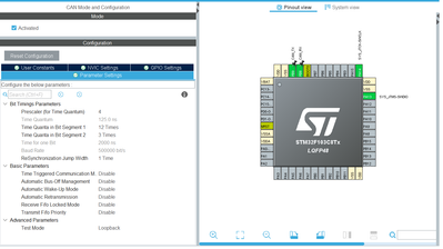

1. First, I use STM32CubeMX to modify CAN pins. I activate CAN, then remap at Pinout View.
2. The kit I borrowed from my mate. And I have searched the web for the schematic, but none match that kit.
I use VOM to find out where the TX and RX on the transceiver are connected to.
2026-01-12 1:11 AM
Ok. Thanks for pointing out my fault. I changed that too. Now, how can I find out what my problem is?

If you didn't change the hardware and remap the pins also in your board to correspond to what you have implemented in the software, that obviously won't work.

I'm pretty sure that I remapped the pins and set bit time segments as you advised. Also, I found and followed your instructions to set up a CAN demo using this link: https://community.st.com/t5/stm32-mcus/guide-to-can-bxcan-can2-0-configuration-in-loop-back-mode-on/ta-p/771119.
2026-01-12 1:33 AM
Based on your first statement: "PB8 and PB9 are used for CAN_RX and CAN_TX pins. When I use PA11 and PA12, it's still OK. But when remapping to PB8 and PB9 with the same code, it gets stuck"
I'm almost sure that's a hardware issue. As I don't have all the hardware elements nor the schematic details, I cannot help you at this stage.
