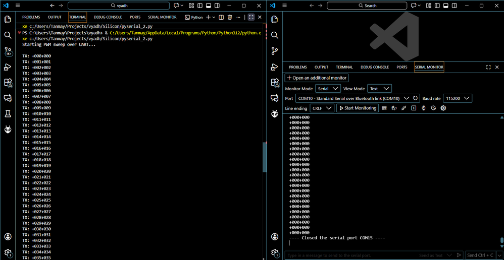

Code is given below in the files:
/* USER CODE BEGIN Header */
* @file : main.c
* @brief : Main program body
/* USER CODE END Header */

THE
THE FIRST COMMAND KEEPS REPEATING ON THE CAN REICIEVER END...... IS THERE ANY LOGICAL ERROR OR CODE ERROR, PLEASE POINT IT OUT

2025-12-08 10:31 AM
After debugging my code I see that the ring buffer is working perfectly fine and the packets are gettings updated periodically in the live expressions........ on the reciever end the RxData and buff variable are staying the same +000+000...... so the RxData buffer is not being overwritten ......... or the CAN is not sending properly..... i dont have a logic analyzer or can analyzer is ther a way to debug this
2025-12-08 12:46 PM
As @Tesla DeLorean mentions, you don't set rx_ready_flag in the callback.
In your main while loop, the code will never send any UART packets because rx_ready_flag is never set.
In your Python script you're not receiving any data but timing out. You're also not testing for a good packet.
At least we know that the first character is a '+'
Try...
resp = None
while resp == None: # will eventually timeout after 50ms
resp= ser.read(8)
substr = resp[0:1].decode() # test for '+' character
if substr == '+':
print(f"RX: {resp.decode(errors='ignore')}")
else:
print("***** No reply, timeout. *****\r\n")
2025-12-08 10:19 PM
I had fixed the flag variable yet had the same problems..... let me modify my pyserial code as well and test ....but my logic of the code is right....
